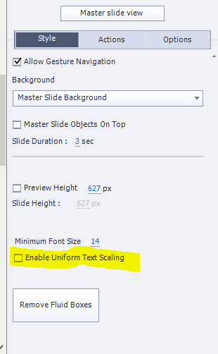

I have "Enable Uniform Text Scaling" clicked for a particular slide with a minimum font size of 14px.  I have a text caption with 20px font size in a fluid box (static).  This fluid box serves as the header for my slide and the text caption is in the center (horizontally) and on top of a smart shape background.
How do I get the font size to shrink when the project does?

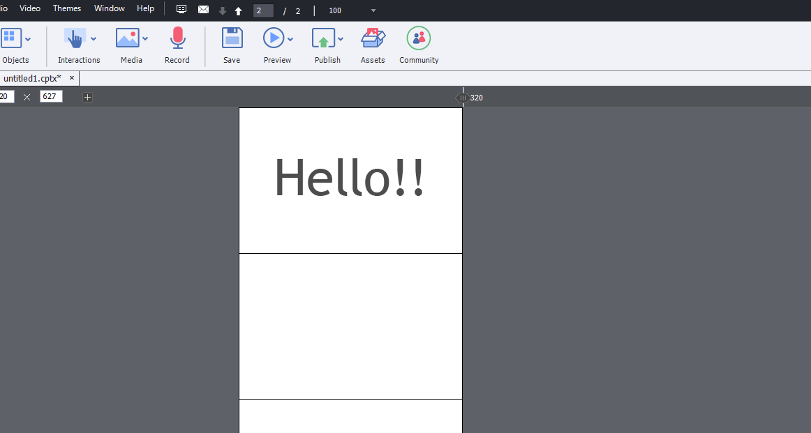

Anyway, here is my work flow:
  1. New responsive project
  2. add "blank" slide
  3. add fluid box to slide : 1 column, three rows
  4. Add text caption to top row, set font size to 72px
  5. at the slide level click "Enable Uniform Text Scaling"
  6. Test the responsiveness with the slider above the slide  ... The size of the font remains 72 pixels even with 320px width. (see screenshot)

Two things...
  1. Text scaling won't change on the stage. You will need to preview the project to see this in action.
  2. If your object containing the text is large enough to accommodate the text even on smaller previews it won't reduce its size.
Try making the object containing the text smaller so that on a desktop view there is only just enough room for the text. Then click Preview > Project and use the slider to see different preview sizes. You should find that it works well at that point. Also, remember that if it's unable to fit all the text in the object even at the Minimum Font Size you will get the pop out text icon in your preview.

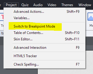

Is there a way to enable the "uniform text scaling" on breakpoint mode?
Karl
Adobe Employee ,
May 17, 2017 May 17, 2017
No, it is not available in breakpoint mode
