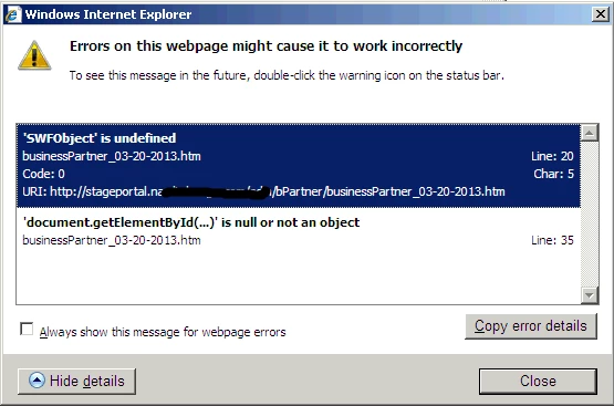

My project runs fine when I test it on my personal web host; however, when we upload it to the corporate site we receive the following error message. Can anyone suggest why this is happening and how I might correct it?
When I searched the forums for the "swfobject is undefined" error, I found a few messages that suggest that the standard.js file is not present in the directory. I have verified that the file is present. However, it has been renamed to standard.js.htm. I tested running the project from my host with the standard.js.htm file and it runs fine.

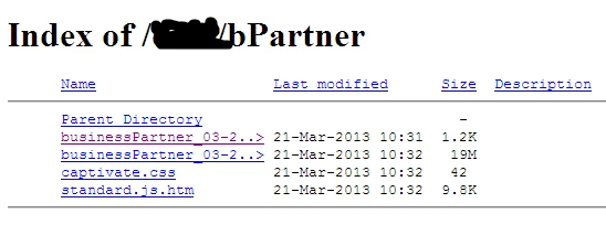

    Yes, the file is present. Here's a screen grab of the directory the server admin sent me. Any other ideas? Thanks.
    RodWard
    April 13, 2013
    The filename of the JS file is wrong.  It's got .htm added at the end of it.  It should be just standard.js
