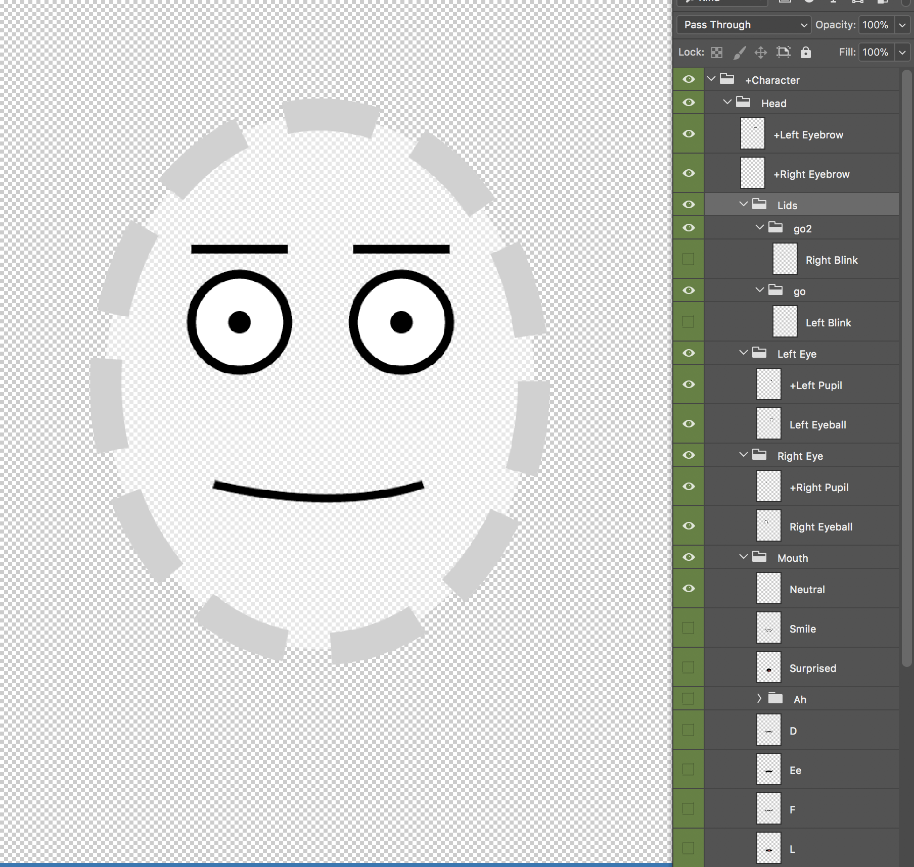

Alan's explanation above is the way to go. Note he didn't do the MASK outside of the eyes like I did in the tutorial video, he did the mask only for the pupil and eyeball (that's what the little down arrow means). I think following his path should work.
If not, there's a hacky way around it, as long as you want your blinks to cover up the whole eyeballs. Do this:
By removing the blinks from the eyes and putting them a few layers deep, they'll react without messing with the eyes, even if a clipping mask is added.

Right. Notice how in mine, I put my blinks inside a Lids group and then inside their own "go" folders. This stops the blinks from hiding everything on the same level as them - because nothing else is at their same level. In your rig mode screenshot they're not in 2 groups deep group like that - they're at the same top level as everything else, which is why everything disappears when you blink.

Adobe Employee ,
Jan 26, 2018 Jan 26, 2018
Remove all mentions / tags of "blink" except for the ones inside the groups and you should be set.
1. Select the "Blinks" group and make sure it doesn't have any tags associated with it.
2. Select the "left blink" and "right blink" groups inside "Blinks" and remove any tags from them. (This is why I named my groups a throwaway term like "go" instead).
3. Select the "left blink" layer and make sure it's tagged as "Left Blink." Do the same with the "right blink" layer and "Right Blink" tag.
