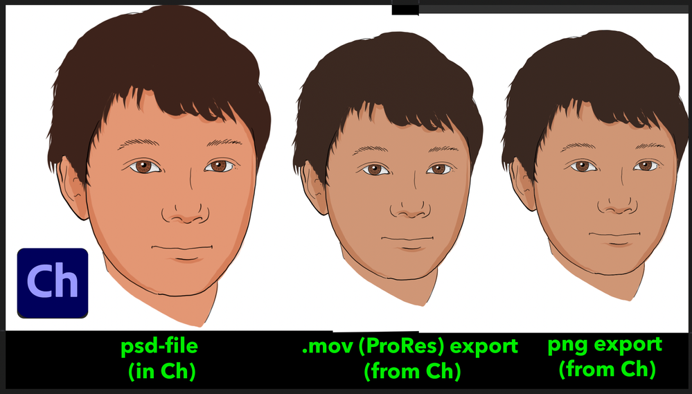

I have no idea why the colors are wrong in Character Animator.
There seem to be no options for colorsettings when omporting files into Character Animator.
Check the Screenshot to see what different colors i get in Ai, Ae and Ch., they all look different.
Anyone the same problem?
and thanks 🙂

Update:
i checked some more settings...my Illustrator-file was in RGB, so rgb/cmyk was not the problem.
When i export png or .mov (via Media encoder) from Character Animator to AfterEffects i always get a colorshift
(see new screenshot)
(btw. working on OS X)
So i still have no Idea what causes this colorshift...Bildschirmfoto 2020-11-23 um 10.47.06.png

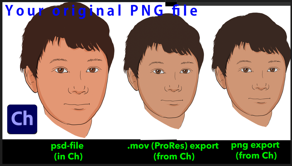

Thanks for your report.
It sounds like there are other possible causes.
I have tested in my environment to see if the same symptoms occur as yours.
But there was no color change.
1) I loaded the PNG file you uploaded into Adobe Character Animator and exported it again as a PNG.
2) I compared the original PNG file with the exported PNG file in Adobe Photoshop.
3) I did not see any color change.
See the linked video.
https://youtu.be/rlLrdaQq_Dg
original_Bildschirmfoto 2020-11-23 um 10.47.06.pngexported_Bildschirmfoto 2020-11-23 um 10.47.06.png

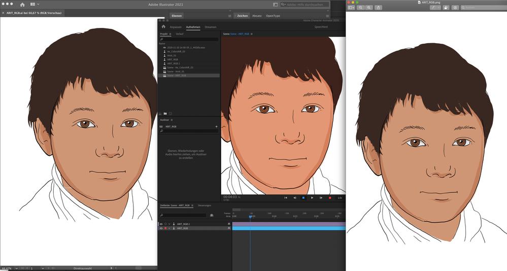

Another update...
So i checked the advice from @David Arbor and converted all layers into RGB...but i still have a slightly colorshift in Character Animator (check screenshot)
The weird thing is that the exported png-file (from Ch) has the right colors (as in Illustrator), but in Character Animator there is still the colorshift...at least the final export of the png from Chracter Animator looks right.
(btw. using Character Animator Version 3.4 / Bulid 185 on OS X 10.14.6 / Mojave)
Thanks for your help!
