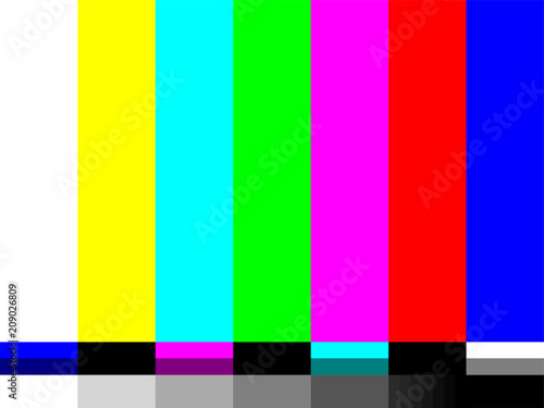

My Character Animation file had a 10-minute long animation (with audio, of course), and for some reason, After Effects would say the file was corrupted when I tried to export from it. When I tried to export from After Effects and Media Encoder, I would get a test pattern similar to this:
https://as1.ftcdn.net/jpg/02/09/02/68/500_F_209026809_BMKfSPSleclpxL9BmWWcCUWvS3lNZPBb.jpg

Ok, I figured out a way to export this... So I'll post what I've done here in case someone gets into a similar issue.
Instead of using dynamic link and export the video into After Effects, I trimmed the animation into 5 different bits in Character Animator and exported directly from it with adobe media encoder. I had to trim the animation into 5 different clips because if I tried to export the whole thing, I would not be able to do it and get some errors also. Probably my machine was not being able to handle such long and complex animation, because I tried exporting other characters and it worked fine.
Trimming the animation into 5 little clips works pretty well for long animations, and now I'll be able to stitch them together on Premiere smoothly.
