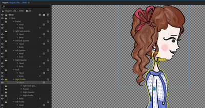

Hey! I was wondering if anyone has run into this issue before and come up with a solution/workaround.
I have a complex puppet with a head turner and multiple views applied to the head and a swap set controlling the multiple body views. I've also got a walk cycle applied. When the walk cycle is running, the head stays sort of pinned and the neck becomes distorted - meaning the head doesn't move together with the walk/body. This happens even if I don't record the face behavior during the walk.
I'm currently working in Beta V23.0.0.8 but I have this problem in the regular Character Animator as well.

To clarify, it's a puppet with 8 views. The Body/Head Turner behavior is only applied to each head, meaning there are 8 separate applications of Turner behavior. The Walk behavior, on the other hand, is applied to the overall puppet, so there's only one of it.

I'm not sure what I'm seeing mesh-wise. The neck is getting elongated so that the face fixed in place (which I don't want.) The dense part of the mesh is where I've got the neck handle and the head handle fixed - I looked at the Maddy puppet to figure that out. When I had the head handle moved to the actual head, the head would fly off.

I don't actually use profiles very often so others might have better advice, but from the screenshots I would say that when Head and Neck are too close together, bad results often occur. I normally put the Neck tag at the shoulder level (the base of the neck). I put the Head tag closer to the mouth in height.
Yes, I would look at other sample puppets. E.g. is it better to have multiple Head layers inside profiles vs the other way around? If you look in the "Face" behavior for your puppet, expand the "Views" and "Handles" etc sections. Many of the behaviors understand which profile is in use, so sometimes it works better to change the nesting. E.g. if you want the Head to rotate controlled by webcam, the Head tag should be on the head artwork (not the neck). That is definitely the sort of thing that can mess up results, so looking at sample puppets to see exactly where they put the Head and Neck tags might help.

Oh, and what to look for in the mesh was trying to spot super dense yellow triangles (a bad sign), or parts of the mesh moving freely with points not moving (when you wanted them to). In this case, because the Head handle is on the neck artwork, the Face behavior is not actually controlling the head. It might even work out better if the head is not independent for your puppet (your call). I find long necks need independent heads less - you can put a stick on the neck to stop it bending too much instead.
So - one experiment: move Neck handle down to base of neck, remove "independent" markers for all the head profile artwork layers, drag the Head handle up higher on the head closer to the height of the mouth and see what happens!

OK, so it definitely sped things up, but the walk issue is still there. But now I'm wondering if I need to move the head and neck tags being that it's not using head turner behavior anymore - and maybe not have the separate heads be independent?

If the rigging in the above images is the same (a layer named neck in the body), I would instead try to a) remove any neck tags, b) select a Head group and move the origin down to the bottom of the chin where it would pivot, and c) select the Head origin and also tag it as Neck.
Basically you want the Neck out of the body and in the Head to help move the whole head.
If you're still having issues feel free to DM me the File > Export > Puppet and I'll take a closer look.

I tried your suggestion with and without indepence applied to the heads and it made no difference - the neck is still weirdly elongated and the head doesn't really move as it walks. So I took you up on your offer. Thank you!
