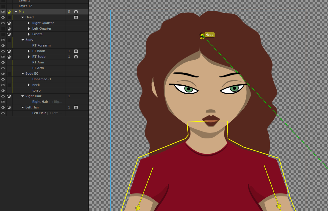

Débutant dans la communauté ,
Feb 08, 2018 Feb 08, 2018
Hey Jen,
I  added a "Head" tag to the Character "Mia" and that seamed to do the trick. Screen Shot 2018-02-08 at 5.09.33 PM.png

Explorateur ,
Didn't work for me, the distortion is still completely wrong. Attached is a pic of what happens. The back hair layers moved with the head perfectly for you? Based on the pic you sent, the head circle should tag shouldn't have the green dotted line that way, it should just be a dotted circle around the tag?

Employé Adobe ,
Feb 12, 2018 Feb 12, 2018
Sorry for the delay in my reply Jen. Glad to see others posting solutions to your problem in the meantime.
> It seems like Auto is setting the hair layers to Body instead of Head.
Indeed that's what happening. This is why: the Auto attach mode for a group means "attach this group's origin to an auto-staple in the parent group -- but only if the parent group has some solid mesh to attach to there, otherwise attach to the parent's origin". That's what the dotted green line is trying to tell you.
So, to fix it, you can still create what the old manual stapling process created:
1. select the Mia group
2. add a handle to the top center of her head
3. hit Return to rename it to "scalp" (so you can find it in the attach menu)
4. select both the Right Hair and Left Hair groups (click & cmd/ctrl-click)
5. set the Properties panel > Layer > Attach To = scalp
Now those back groups will move with the scalp handle -- which, since Mia and the Head group share the same mesh (since Head doesn't have a crown) moves with them too.
Frankly, I was surprised this worked so well, because having a handle in Mia that's placed off of the mesh like that usually leads to problems (which are fixed by adding an invisible eyeball-off "neck" or whatever to create enough mesh so that the handle is embedded in it). That's why Auto doesn't do this for you automatically. But this gives me hope that we can make it always do this, which would mean less rigging work for you!

This method worked very well for me too. With this method, I'm still struggling to get my hair Dangle to work well, but will continue to experiment.
Thanks!
