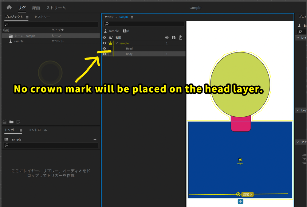

Jun 03, 2024 Jun 03, 2024
Japanese is converted to English using translation software.
(1) No crown mark is added to the head layer.
2) Draw the stick tool on the bottom of the body layer and add a fixed tag.
Please try it. Thanks.
