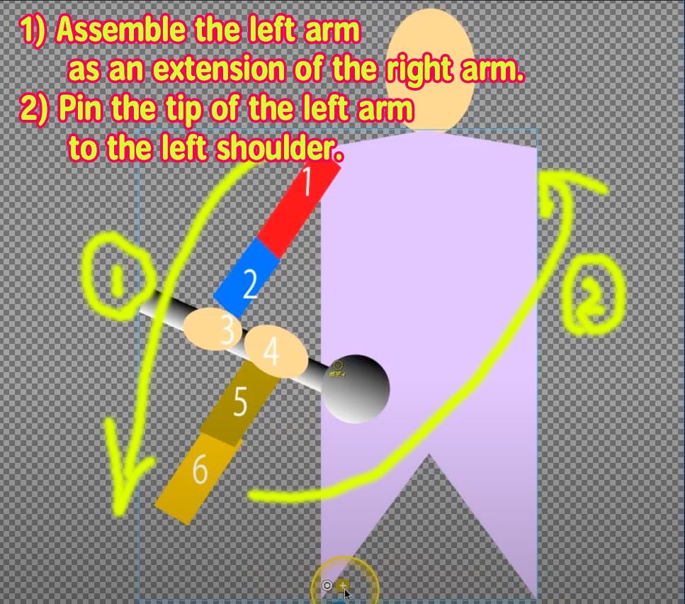

its solved thanks but one more question sir can one objects hold in both hands like cricket bat  im struck at this topics
LEGEND ,
Dec 08, 2020 Dec 08, 2020
Simple answer: no - everything has one parent that it obeys. You cannot have an object with two parents controlling it. They just fight and one wins and it results in martial disharmony... err, sorry, I think I got off topic there. Basically things follow their parent, and a layer cannot have two parents. Even magnets are just a way to turn on/off this following rule (it must still be a parent/child relationship).
Complex answer: there are tricks.
- You can drag the two arms around together so it *looks* like they are connected.
- You can draw both arms onto one layer so it is really one big arm that moves (but it does not flex as well)
- You can have two separate draggers that both move at the same time
- You can use cycle layers and swapsets for some animation - remove the normal arms, display a sequence such as holding and swinging bat
Yes, it would be useful to support natively - but I dont know how to do it easily. It would be very useful to do at times. E.g. people have talked about walking a dog on a lead - how to have the lead join the two objects? I guess an idea is to have a dragger that can follow some handle on another puppet. If the handle moves, the dragger is moved. But I don't think this is possible today.
Dec 09, 2020 Dec 09, 2020
Japanese into English with translation software.
A limited use is an example.
1) Assemble the left arm as an extension of the right arm.
2) Pin the tip of the left arm to the left shoulder.
I have uploaded two instructional videos to YouTube in the past.
They are Japanese explanations, but I think you get the gist.
They can be found at https://youtu.be/3mWAWirs-FA?t=96
https://youtu.be/IKXLhu4soSU?t=174
I'd be glad if that method helped you.
