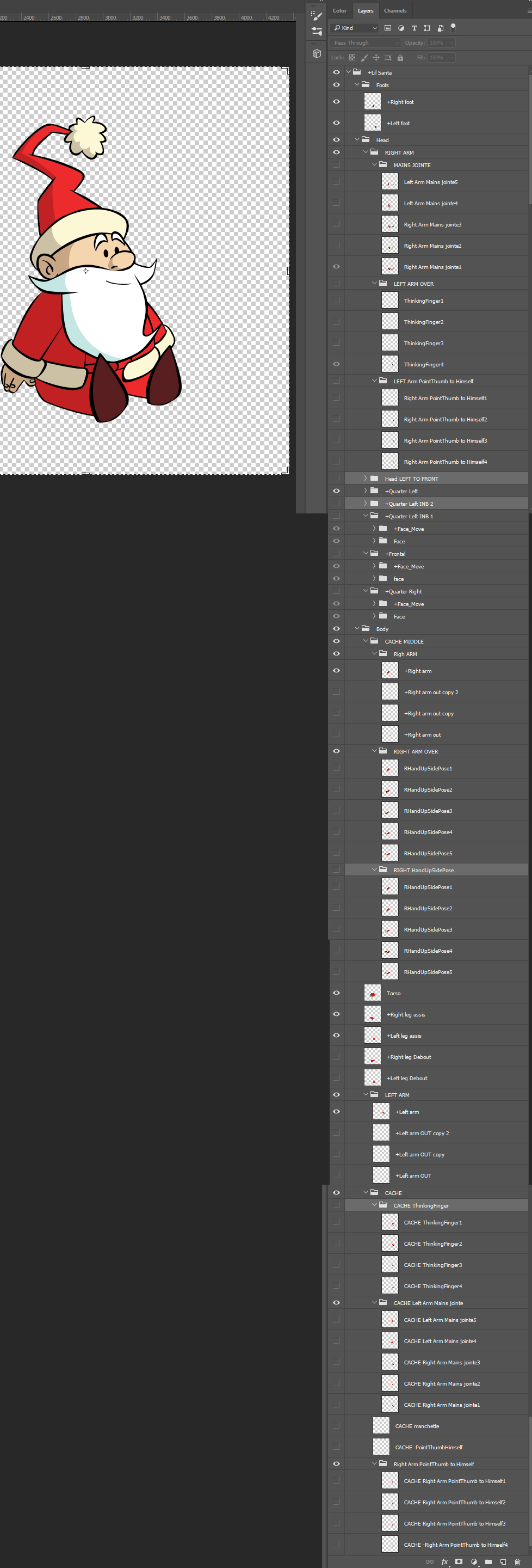

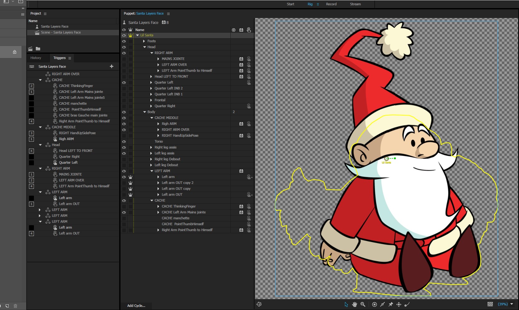

I have several problems in the Character Animator software, firstly I have a character who needs to have an arm so the shoulder is behind the beard, but the hands can go over the beard, I fixed the problem by making a copy of the arm, I erased a part on a layer and another part on the other layer, which causes me other problems. Since it is not possible to have all the animated arms to make the animations in the same file as the arms (by default) some of them need to be behind the body of others over the body and even certain to the middle. The arms (by default) do not disappear automatically when I activate the animation using a trigger, I tried to do cycles layers to make them disappear, but, either they disappear at the end of the animation and did not reappear, or the arm reappears before the end of the animation when you release the trigger. Is there a way to make something disappear with a given time after the trigger or any other solutions?

Can you screen shot your layer order in PS/AI and also in how you have set up the rig etc.

Great character!
For the arm appearing issues - this is tricky currently because we don't have a great front/back swap solution currently. Personally I would do some sort of timed trigger system where one trigger runs arm cycles in front and behind - and for the one you don't want to show, just make them blank frames/layers. So if the static arm is behind the beard/head but the moving one has a 3-frame animation, make two "raise" groups (one above, one below), each with 3 frames and cycle layers attached, and trigger them both with the same single trigger.
If you make major structural changes to your PSD/AI, CH can't always reconcile all the new stuff and you may lose rigging if it can't find the previous layers/groups. We're working on making this better but for now I'd save any intensive rigging until you feel the puppet structure is more or less done.
