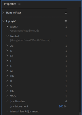

I have only used characterizer once. Happy to help try and debug if useful. Eg if you go into the Lipsync behavior it should should james like Mouth and then lots of viseme names like Ah, Uh, etc. Next to these should be a number. If zero, it means the behavior did not find the tagged layers. Behaviors look for tags on layers to control the puppet. The layer name if "Ah" with get auto-tagged with Ah to save effort, but its the tags that matter not the layer name. (you can manually add and remove tags on layers). I am wondering if characterizer is getting it wrong. Could you show a screenshot of the lipsync behavior expanded?

Here is an example screenshot of what i am after. If you look at "Mouth" you see (pale gray) it found the mouth layer in the artwork. It also found the visemes inside the mouth layer group. This is step 1 - making sure the Lipsync behavior found the layers.
Note: There is also the Face behavior - if you smile with the camera on, does the puppet smile? The "Smile" and "Surprised" visemes are controlled by the Face behavior based on the webcam. The rest are based on audio processing. So if the lipsync behavior has found the layers, the next thing is to make sure it is getting the audio processed or not. E.g. can you record audio file and play it back and hear your voice?
Then if that works, can you use "Compute from Lipsync" to generate visemes in the timeline panel for a scene. But can walk through each step one by one.

Thanks it looks like the lip sync did not find the layers as all my values are zero in that panel under lipsync - what I do to help it find them?
