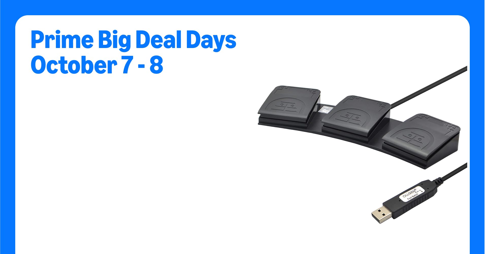

I'm Livestreaming with my puppet using a Midi Keyboard next to my own to run its triggers. However It would really help my live stream to have some of my triggers connected to footpedals. Actual MIDI footpedals are expensive so I purchased a set of OLLGEN USB footpedals https://www.amazon.com/gp/product/B08M9TXWV2/ref=ppx_yo_dt_b_asin_title_o02_s00?ie=UTF8&psc=1 Which supposedly support MIDI keys, but for whatever reason Adobe Character animator isn't picking them up (When I set up the MIDI keys there it says it needs to paired with other software so that whole MIDI Key thing advertise is a bit SUS in my opinion) But thats offtopic. I'm curious if anyone else who uses character animator knows a way to set up USB footpedals to be recognized as MIDI tools so they can trigger Character animator? If there is some third party software or driver that can convert them would be helpful. Thanks.

The description on amazon sounds like it comes with software to program the device to make it do different things, include send midi events. There are also command and note events https://www.noterepeat.com/articles/how-to/213-midi-basics-common-terms-explained. Some events are on/off, others are like a slider with a value. I suspect you have to program your device using provided software to generate an event that adobe ch will understand. I know note events work, but i don't recall if ch will listen to command events...

It looks like the software it comes with is only able to produce Note commands, which don't seem to be picked up by character animator. are there any alternate softwares that could take the note command and spit it out as a Note event?

Notes should work - it was the control change commands that i was not sure about. How do you know if the device is sending midi note events? Eg can you get something else to listen and play a note when you press a foot pedal?

The keys are detected on Piano 10, but they don't play anything and keys just stay stuck pressed down, and pressing them again, doesn't push them back up its strange.

My guess is it is generating note on events when you push it but not note off events when you release. Also the velocity (volume) might be zero. That may be fine for ch - it does not care about volume, and if a swapset the next note on will turn off the previous trigger.

This usb foot switch keyboard mouse control foot pedal is equivalent to a standard USB keyboard and mouse with one key, the key can be defined through the supporting software as keyboard,mouse,multimedia.game,string,macro definition and MIDI function.
Have you used the supporting software to control it?
If it works fine, you can assign keys to the pedals just like you would on a PC keyboard.
If it doesn't work as a MIDI controller, try that.
By the way, does that USB Foot Pedal work fine with other applications?

The keyboard functions work fine with other programs but the MIDI controls seem to be iffy. I tried using Piano 10 with an assigned midi Key but the key just stays stuck pressed down. Like the note is continous. What translation software do you use by chance. If possible i could convert keyboard strokes or macros into MIDI Notes that would work too I think.

If the foot controller behaves like a PC keyboard,
Is it possible to assign keyboard keys to a foot switch?
For example, "A" on the right, "S" in the center, and "D" on the left?
Can it be used as a regular keyboard trigger, not as a MIDI keyboard?
P.S.
The reason why the keyboard does not return on Piano 10
MIDI note-off information may not have been received.

yes it can be configured to do normal keyboard keys. That might be the reason why Piano 10 isn't working with the MIDI notes I wonder if thats why character animator doesn't pick them up.
