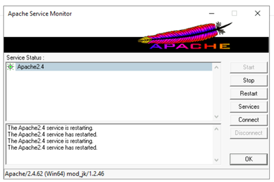

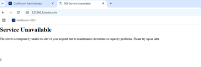

The Apache localhost service works correctly, it allows me to browse .html pages; but when I try to browse .cfm pages it shows me the following error:
maryorie01_5-1730316995762.pngmaryorie01_6-1730317030576.pngmaryorie01_7-1730317149778.png
I really appreciate your guidance in solving this problem.

@maryorie01, please try adding the server's IP address to server.xml and workers.properties and restarting both the Apache and CF servers.
Server.xml is located at \ColdFusionxxxx\cfusion\runtime\conf:
Example:
<!-- begin connector-->
<Connector packetSize="65535" protocol="AJP/1.3" port="8020" address="IP-OF-SERVER" redirectPort="8453" secret="0f679950-252f-4b7a-96b1-b4c43650c9dc" maxThreads="500" connectionTimeout="60000" tomcatAuthentication="false"/>
Workers.properties is located at \ColdFusionxxxx\config\wsconfig\magic_folder:
Example:
worker.cfusion.type=ajp13
worker.cfusion.host=IP-OF-SERVER
