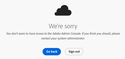

I can't seem to open a case with adobe as I am getting the error below and the admin is no longer available.
