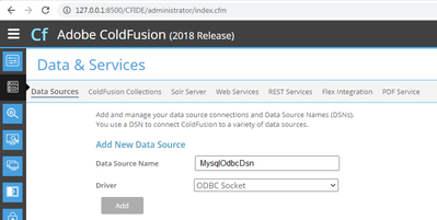

> Open the ColdFusion Administrator and navigate to the Data Sources page. Use the 'Add' button to create a new ODBC data source as follows:
> When you press 'Add', you get an interface similar to the following:
 > Fill in the details and press 'Submit'
