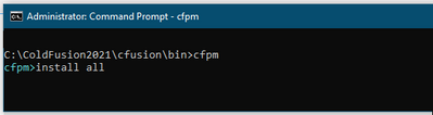

Yes, it might. Unlike previous ColdFusion versions, ColdFusion 2021 is modular. This means you can pick which packages to install in CF2021. So, it just might be that a package that your application needs was left out during installation.
To check out that idea, here is a suggestion:
  • (Assuming you are on Windows) Open the Command Prompt (cmd) as Administrator;
  • Use the DOS cd command to navigate to  {CF2021_HOME_DIR}/cfusion/bin;
  • Type cfpm and press ENTER. You should get ColdFusion's package manager prompt cfpm;
  • Run the command install all
  • Keep running the command install all till the result is either an error or ColdFusion tells you that "All the packages are already installed".
  • If the former, then share the error message with the forum. If the later, then restart ColdFusion in the usual way, and see if that solves the problem.

Well, I tried the above... Now CF and SQL aren't speaking. I can't establish a connection between the two and they are even on the same server.
Please advise.

I was referencing the solution posted by BKBK.
Specifically where it was suggested:
"To check out that idea, here is a suggestion:
Run the command install all"
Now that I've done that, my Data Sources won't work. I doubled checked that the SQL account is viable and even tried adding a new one. No matter what I try, CF responds with:

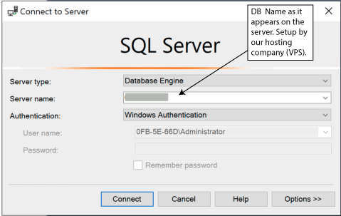

Participant ,
Oct 16, 2023 Oct 16, 2023
Thank you for your patience. I've never had a box come apart like this on me before.
As suggested, the following is additional information broken down using screenshots.

From the CF admin, here a few select entries from Server Settings/Settings
SQL
This is the login to Microsoft SQL Server Management Studio (Administrator).
Next, we expand out the list of Databases. Important note, there are 5 listed, but only two are in use. Of the two, bigspring is rarely used while the one I need to connect with is HODRRM.
Next, we expand Security to expose the logins. All unrelated logins are masked. Bigspring is shown only for reference.
Right clicking on HODRRM and selecting properties shows the following. Again, the login name and password are the same as what was entered into CF.
Drilling down, I’m guessing this matters, is the Status screen.
I can also use the login account, HODRRM, to login to Microsoft SQL Server.
Then, of course, I can expand the listing for HODRRM.
Have I missed anything that would prove helpful?
