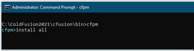

As ColdFusion itself has suggested, you can solve all the issues of type
The xyz package is not installed.
by using ColdFusion's Package Manager tool (cfpm). You could pass the following steps on to your System Administrator:
  1.  Open the Command Prompt (cmd) as Administrator.
  2.  Use the CD command to navigate to C:\ColdFusion2021\cfusion\bin.
  3.  Type cfpm and press ENTER. You should get ColdFusion's package manager prompt cfpm
  4. Run the command install all.
  5. Keep running the command install all till the result is either an irreversible error or ColdFusion tells you that "All the packages are already installed".
    6. If the former, then share the error message with the forum. If the later, then restart ColdFusion in the usual way, and you're set to go.
    7.  If you need to remove any unnecessary packages, you can then do so in the Package Manager page in the ColdFusion Administrator.
