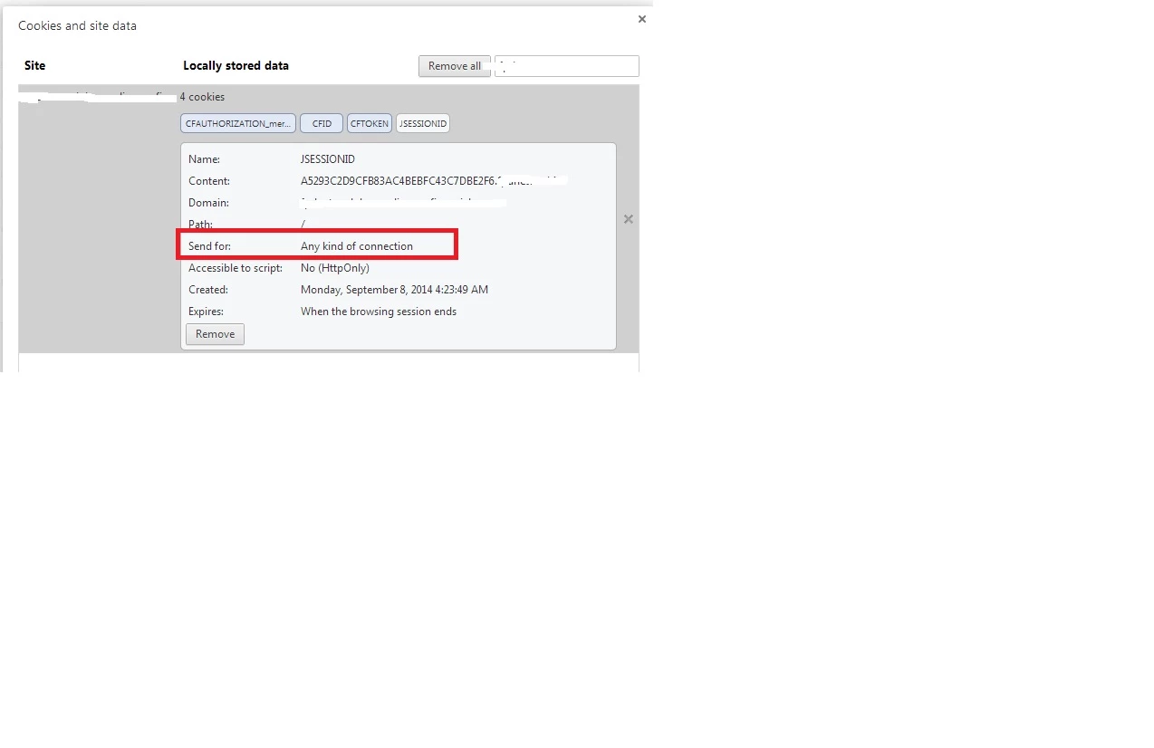

1]We dont have access to check this in CF Admin->Server Settings->Memory Variables. Any way This is a server level side solution and it may impact other applications in the same instance as well.Right?? But I think the impact is not a negative impact as we are just securing the session cookies.Right???
2]To do this via code , In Application.cfm (not using Application.cfc as our application is existing and old one) I created a structure with the required properties and passed this to the "sessioncookie" attribute in "cfapplication" tag as below.
  <cfset cf_ssn_cookies = {httponly='true', secure='true'}>
  <cfapplication name="mer_auth_lookup" sessionmanagement="yes" setclientcookies="yes" sessioncookie=#cf_ssn_cookies# >
But it seems to be not working when I checked using chrome developer tools where I found empty values for the columns HTTP and SECURE as in the attached screen shot.
Here Could you pls tell me the method I followed to set HTTPOnly and Secure flag for the session cookies is correct or not. If it is correct plese let me know whether I am following correct steps using chrome web developer tool to check whether session cookies has been set with HTTPOnly and SECURE flag .
And If I am following correct steps to test why it is not working when checking in chrome developer tools.
BKBK
September 2, 2014
Using cfapplication's sessioncookie attribute is fine, too. For completeness, use something like
  <cfapplication name="mer_auth_lookup" sessionmanagement="yes" sessiontimeout="#createtimespan(0,0,30,0)#" setclientcookies="yes" sessioncookie="#cf_ssn_cookies#" >
