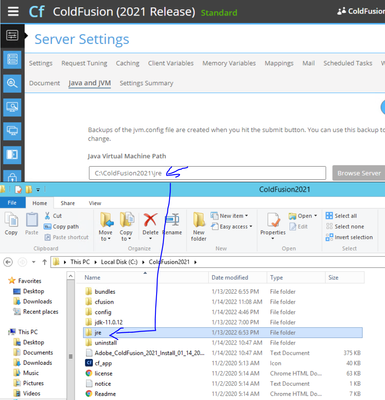

Is the above related to this setting?  Should I point the Java Virtual Machine Path to C:\ColdFusion2021\jdk-11.0.12, which was the setting in CF2018?
No, I don't think the error is related to the Java setting. But I would strongly advise you to point CF2021's Java Virtual Machine path to C:\ColdFusion2021\jdk-11.0.12. Perhaps even better, install the latest Java [ JAVA SE 11.0.14 (LTS)and let CF2021 point to it.

I point the JVM Path to below where Java 11.0.12 is stored.  Re-started the Cold Fusion 2021 Service.  And my webpage showed up!
I downloaded the CF2021 within the last month.  Somehow, the Java coming with the install was 11.0.1.
