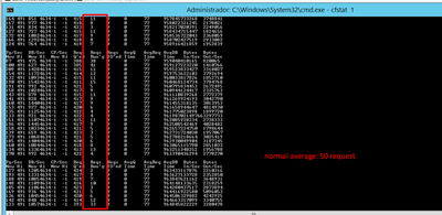

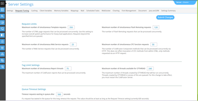

I have a server with Windows Server 2012 R2 and a CF 2021 in production, we have a problem with the request tunning configured on the server(240) that sometimes arrives to the maximum configured and the service goes down. Sometimes is necesary a restart the service for continues with the service.
The Datasource PostgreSQL configured on the client is configureded to Restrict connections to 210.
We had the same configurations implemented on a CF 2016 and a service of monitoring without problems.

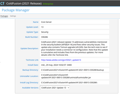

The update of CF2021 is the version 13, I attach a snapshot about that.
We activate a service of monitoring FusionReactor and the requests goes up until double or more of connections, so the system is very loaded and blocks easier.
So we don't know what's happening we attach some snapshot about cfstat, FusionReactor and request tunning configured.
I hope you can help me
Best regards.

    I would like to comment that we have managed to stabilize the platform by making adjustments to the simultaneous Template requests parameter, we had it at 325 and now we set it to 350; we also made adjustments to the workers.properties and server.xml files, modifying the following values:
    workers.properties
    - worker.cfusion.max_reuse_connections: 1200
    - worker.cfusion.connection_pool_size: 8400
    server.xml
    - maxThreads: 8400

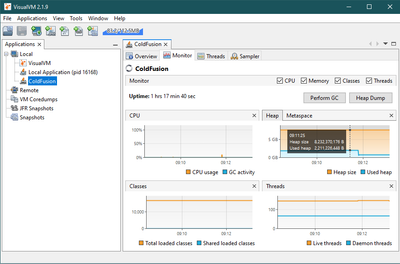

    Pic1
    Pic2
    Pic3
    As you can see in the screenshots, the tweaks helped keep the platform stable but currently we can only monitor using cfstat via a DOS window. Despite the apparent stability, we have episodes that can vary between 4 to 30 seconds where the active requests shoot up to the maximum and reach the maximum value set for the server, a screenshot of this is attached. (Pic2)

    Q: Your application is apparently memory intensive. So what is the server RAM and values in the java.args property in the jvm.config file of the ColdFusion application?
    A: The server has 256GB of RAM installed and has between 16GB and 64GB of RAM allocated, as seen in the parameters below
    java.args=-server  -Xms16384m -Xmx61440m --add-opens=java.rmi/sun.rmi.transport=ALL-UNNAMED --add-opens=java.base/java.nio=ALL-UNNAMED --add-opens=java.base/java.lang=ALL-UNNAMED --add-opens=java.base/sun.util.cldr=ALL-UNNAMED --add-opens=java.base/sun.util.locale.provider=ALL-UNNAMED --add-opens=java.base/java.net=ALL-UNNAMED --add-opens=java.base/java.io=ALL-UNNAMED -XX:+UseParallelGC -Djdk.attach.allowAttachSelf=true -Dcoldfusion.home={application.home} -Duser.language=en -Dcoldfusion.rootDir={application.home} -Dcoldfusion.libPath={application.home}/lib -Dorg.apache.coyote.USE_CUSTOM_STATUS_MSG_IN_HEADER=true -Dcoldfusion.jsafe.defaultalgo=FIPS186Random -Dorg.eclipse.jetty.util.log.class=org.eclipse.jetty.util.log.JavaUtilLog -Djava.util.logging.config.file={application.home}/lib/logging.properties -Dtika.config=tika-config.xml -Djava.locale.providers=COMPAT,SPI -Dsun.font.layoutengine=icu -Dcom.sun.media.jai.disableMediaLib=true -Dhttps.protocols=TLSv1.2 -Dcoldfusion.cpu.count=8 -Dcoldfusion.searchimplicitscopes=true -Dcoldfusion.classPath={application.home}/lib/updates,{application.home}/lib/,{application.home}/gateway/lib/,{application.home}/wwwroot/WEB-INF/cfform/jars,{application.home}/bin/cf-osgicli.jar
    Q: What is the value of "Queue Timeout Settings" (in the ColdFusion Administrator)?
    A: 560 seconds; this value was defined by the dev team, this is because we have processes that take a long time to be executed, according to what the dev team indicates this delay is normal. If for example, we lower this value to 60 seconds, timeout errors begin to be reported by system users.

    I'm going to throw some darts here. First, what happens if you turn off your monitoring service for a while?
    Second, how did you get to those numbers for CF request tuning and database connection limits? They presumably came from somewhere. The CF request tuning limit seems awfully high to me. I would spend some time with a load test tool and see why those numbers are as high as they are.
    Third, what happens when you try to optimize the slowest page as best you can? What part of that page is slower than the rest? You should be able to use CFTIMER to break the page into separate parts and see what's going on. My guess is that your database query is really slow when it presumably shouldn't be (I'm not going out on much of a limb there) but at least it's a start. Take that query and use whatever query analyzer PostgreSQL has, so you can figure out why it might get slow under load (no indexes, bad indexes, poorly-written SQL, poorly-designed DB structure for INSERT/UPDATE, poorly-designed DB structure for SELECT). This is an area where @Charlie Arehart or someone else can probably help you quickly.

    Hello Dave, thanks for answer.  My name is Romina, and I work on the same team as Pedro, so I'll be addressing your questions.
    Firstly, the system operates smoothly when we do not use the monitoring service.
    Secondly, those numbers come from our experience. We've been using them for many years and have adjusted them based on server responses. However, we will review the CF request tuning limit since you mentioned it seems quite high. Is there a method you know to calculate it that isn't empirical?
    Thirdly, the pages do not show slowness, and the system functions well when we do not activate CF Reactor. We've spent the last three years optimizing queries, indices, etc., so I don't believe the issue lies there. We also recently validated this with an external DBA.
    Thank you very much for your assistance and your responses.
