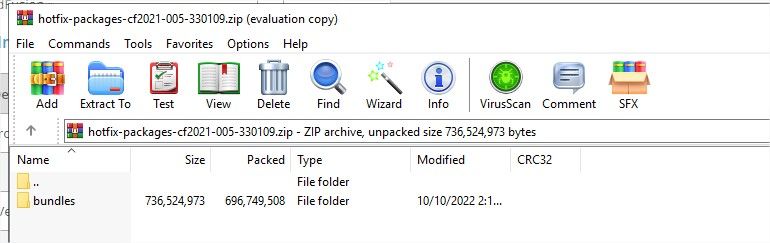

    Hi All,
    we figured out a problem with bundlesdependecy.json file which I have corrected and upload the package again. Here is the latest checksum - 6c918247c08b4d9fe5e8f2fdd4f8487e
    https://cfdownload.adobe.com/pub/adobe/coldfusion/2021/packages/hotfix-packages-cf2021-006-330132.zip
    Please roll back the update and then try with this package in your offline server,
    Thanks, Priyank Shrivastava
