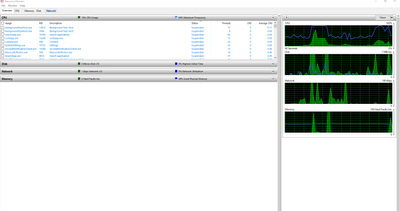

New Here ,
Jul 14, 2022 Jul 14, 2022
This is my resource
I hope this image is readable.
  monitor
Bruce, PLEASE read things more carefully. No, those images don't help. I said (in the comment above from 2018) that in that resource monitor one should look at 'its network tab, On that, see its "listening ports" section, which is sorted by port. Is cf shown there listening on 8500?', or in your case 8501 since that's what you show trying to load in the url.
