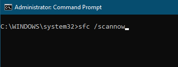

Sep 14, 2023 Sep 14, 2023
quote
So, what should be the next step to resolve?
By @RzAf
Check whether the cause is a virus, malware or a corrupted file in the Windows Operating System.
You or your admin could, for example:
  1.  Run an anti-virus program.
  2.  Open the Command Prompt (CMD) as administrator, then run the System File Checker tool: sfc /scannow
