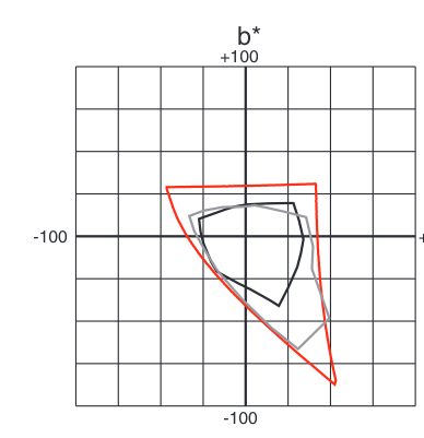

Now let us compare some gamuts. Common 3D visualizations are not really suitable,
therefore I'm using slices in Lab for a set of L values, here on p.19:
http://docs-hoffmann.de/gamshow15052009.pdf
AdobeRGB (red curve), ISOCoated-v2-eci (black curve), Inkjet Mutoh 6100 (gray curve).
Curves for sRGB are found on other pages.

Now let us compare some gamuts. Common 3D visualizations are not really suitable, therefore I'm using slices in Lab for a set of L values, here on p.19:
We are in full agreement there!  Great illustrations!
No doubt, that RGB operated inkjets are widely used by Photographers for 'fine art printing'.
That's precisely what I thought I had said and what I maintain.
That's not only a matter of gamut (which is not increased by RGB) but also a matter of black generation by multiple gray inks, by excellent dithering modes and knowledge how to avoid bronzing and how to reduce illuminant metamerism. Perhaps these methods are already optimized, therefore it's not necessary to offer to the photographer full control over all parameters.
Again, I agree 100%.
Best regards --Gernot Hoffmann
In a nutshell, what I was trying to get across is that, for photographs and in the price range of the model the original poster described by naming make and model, I would not choose his CMYK printer for fine art photographs to display on a wall (to be more precise), nor would I consider any CMYK printer under those conditions.
                    © Gernot Hoffmann
If you think I'm missing the point, please don't hesitate to let me know.

»station_two« , I don't think we disagree (any more).
Some years ago, CMYK printers used Adobe PostScript and were generally high quality devices,
expensive because of both reasons.
I'm surprised that such a low-cost printer is equipped with a PostScript clone (emulation) which
is probably not bad, concerning the language implementation. I wouldn't use either such a printer
for quality prints.
