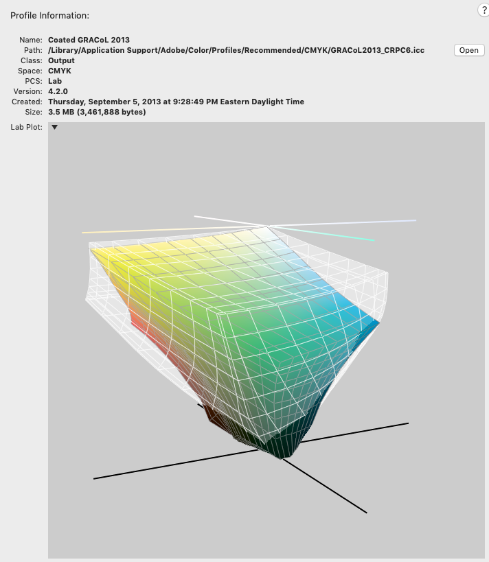

sRGB clips a significant portion of the typical CMYK gamut, so if you wanted to color correct an RGB image and get at the entire CMYK output space, you would have to make the conversion into a larger RGB space and adjust the output numbers. Gamuts go both ways there are RGB colors that can’t be printed, but there are also CMYK colors that can’t be displayed in sRGB. Here’s a 3D model comparing sRGB (white) with the GRACol Coated press profile, it shows the part of the GRACol space you would not be able to get at when editing in sRGB.
While, most of GRACol is inside of the AdobeRGB space—you can color correct to the saturated blues, yellows, and greens that sRGB clips:
