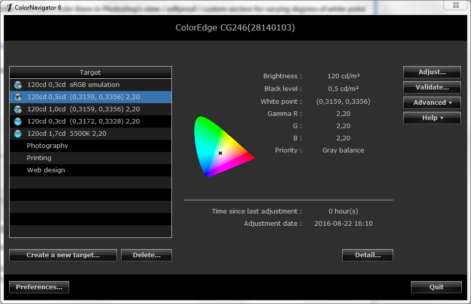

An alternative approach is to handle this with different calibration targets, to match different papers and press conditions.
In other words - monitor white point is set to visually match paper white, and monitor black point is set to visually match max ink density. This means document white should just map directly to monitor RGB 255/255/255. The softproofing stage just deals with out-of-gamut and nothing else.
You'll have to be able to handle multiple targets/profiles in the calibration software, but this is very simple in NEC Spectraview, Eizo ColorNavigator and probably also in BasICColor.
Here's how it looks in ColorNavigator. Note the different white and black points:
I even have one "make it look like sh*t"-target - this is used for a certain uncoated paper stock with PSO Uncoated ISO12647 (eci), and gives a surprisingly good visual match.

Hi D Fosse,
Yes a selection of calibrations is certainly one approach, thanks for mentioning.
In an environment, though, where, say, a designer needs to switch between coated and uncoated output many times during a typical day, that would get forgotten perhaps. ColorNavigator does make that easy though, for sure.
Additionally, I'd like to have the facility to accurately compare coated and uncoated soft proofs alongside each other. So, ideally I feel the solution IS editing the profile white point and using AbsCol rendering to the screen (i.e. Simulate paper white activated).
