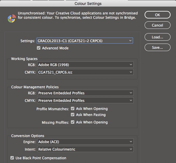

INDESIGN CS6: When I choose 'GRACOL2013-C1', the CMYK working space is set to: 'CGATS21_CRPC6.icc'.
ILLUSTRATOR CS6: When I choose 'GRACOL2013-C1', the CMYK working space just says 'other'.

In INDesign CC 17, I see this when I load the CSF - seems to be what you are seeing with CMYK=CGATS21_CRPC6.icc ?

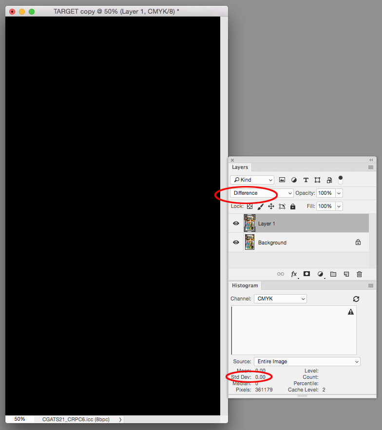

Sep 08, 2017 Sep 08, 2017
did you allow the offered conversion to take place?

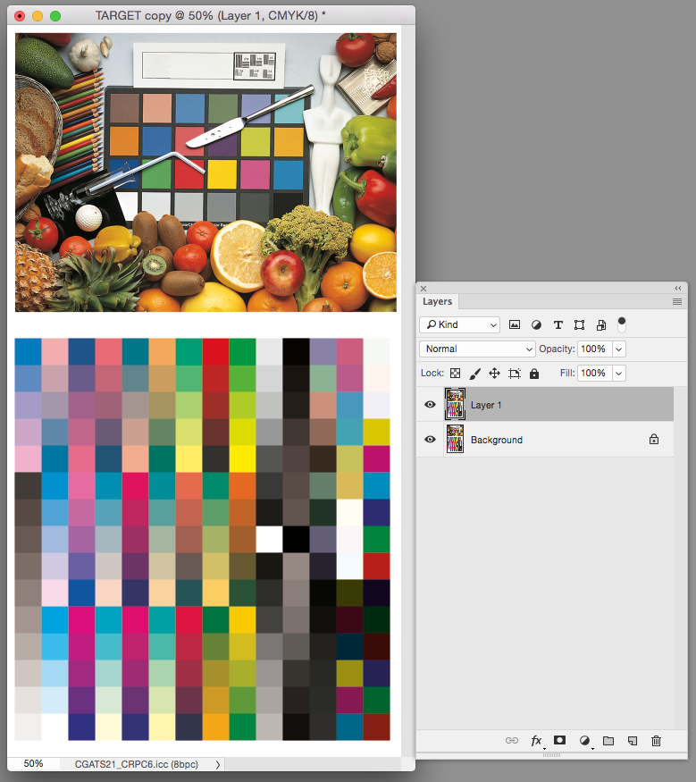

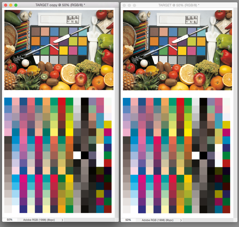

No, if I get a warning I preserve numbers in order to see any differences in the conversions:
The identical RGB
The conversions (if i sample the patches they are identical):

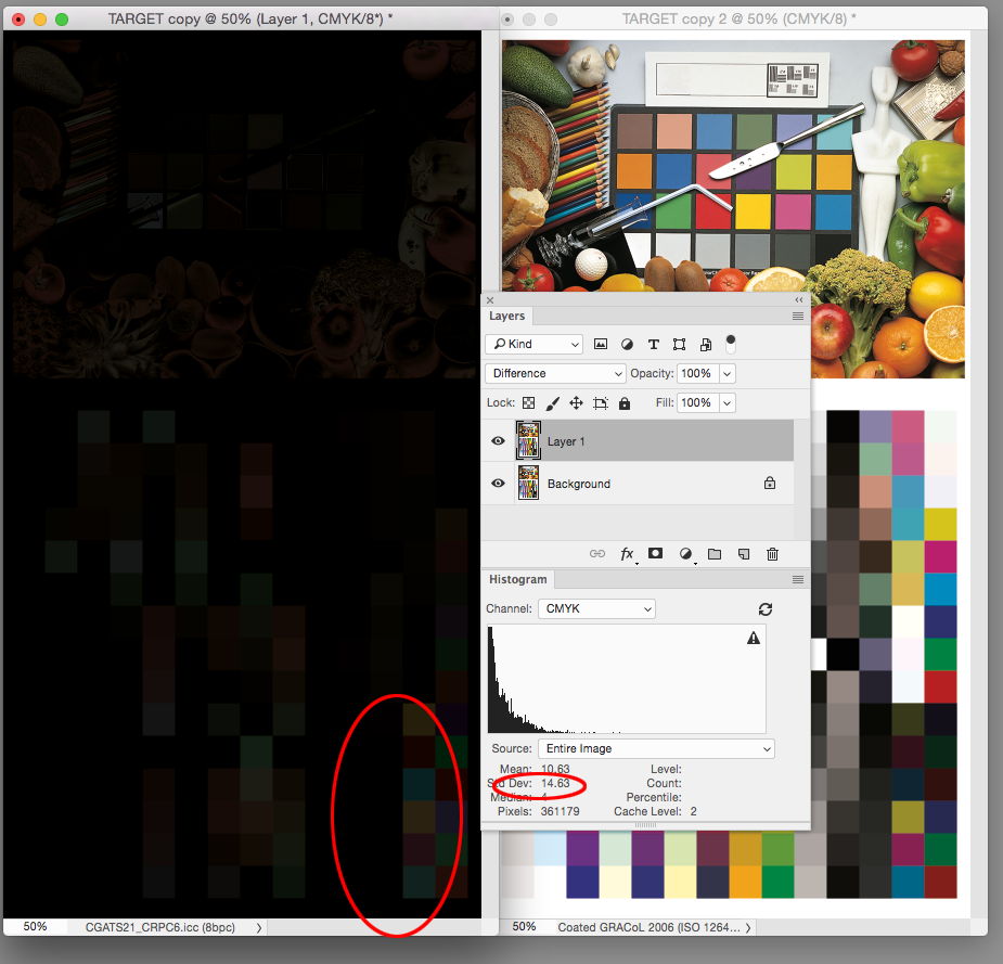

The two layered with the CMYK numbers preserved:
The difference

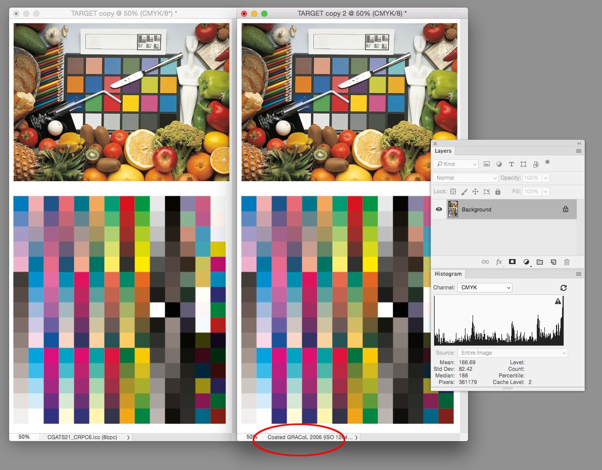

If I check GRACol 2013 vs. GRACol 2006 there is a difference mostly in the black generation—2013 has a heavier black plate.

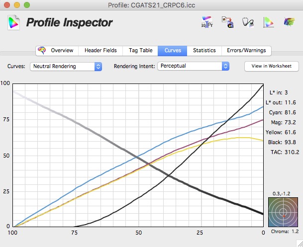

After doing a little more digging, it looks like 'CGATS21_CRPC6.icc' and 'GRACoL2013_CRPC6.icc' may be the same (or GRACoL is derived from CGATS21).
Below are the perceptual curves FYI.
I think you are probably right. The fact they are from the same press data doesn't mean that are the same - since profile softwares differ and also profile building includes options like TAC, max K, K start, GCR level, K width etc. of course those options can alter the actual profile significantly.
