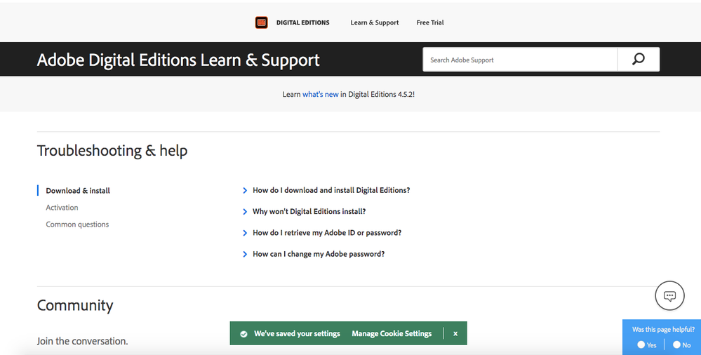

Mar 27, 2022 Mar 27, 2022
How did you guys download the 2.0 version? I'm not seeing it anywhere on this page that's linked. Please help! ThanksScreen Shot 2022-03-27 at 9.00.28 PM.png
New Here ,
Apr 10, 2022 Apr 10, 2022
https://www.adobe.com/solutions/ebook/digital-editions/download.html
Adobe only has ADE 4.511 and 3.0 on this page. I was using 3.0 then had problems with ADE opening/getting  the library ebook I borrowed from Overdrive. Then I used 4.511 with some success but the authorization problem started. Being able to open the borrowed ebook via ADE on the computer and kobo (via ADE) doesn't necessarily mean that when kobo is unplugged from the computer, kobo will be able to open said ebook. That's what has been happening to me before I found this forum. I tried to go back to ADE 3.0 but it won't worked on my Windows 7 anymore. It keeps crashing.
This is where I found 2.0. I de-authorized both computer and kobo. Downloaded again from the library the problem ebook. Before download started, I was prompted to authorize my computer. Re-authorized kobo. It worked! Kobo can open a borrowed library ebook without being plugged in to the computer.
Good luck!

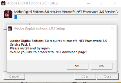

Community Beginner ,
Sep 12, 2022 Sep 12, 2022
I got as far as step 7, and cannot install DE 3.0  due to the requirement for microsoft .net framework 3.5, which as far as I've been able to find, is not compatible with windows 10. Is there a work around for this?image.png
