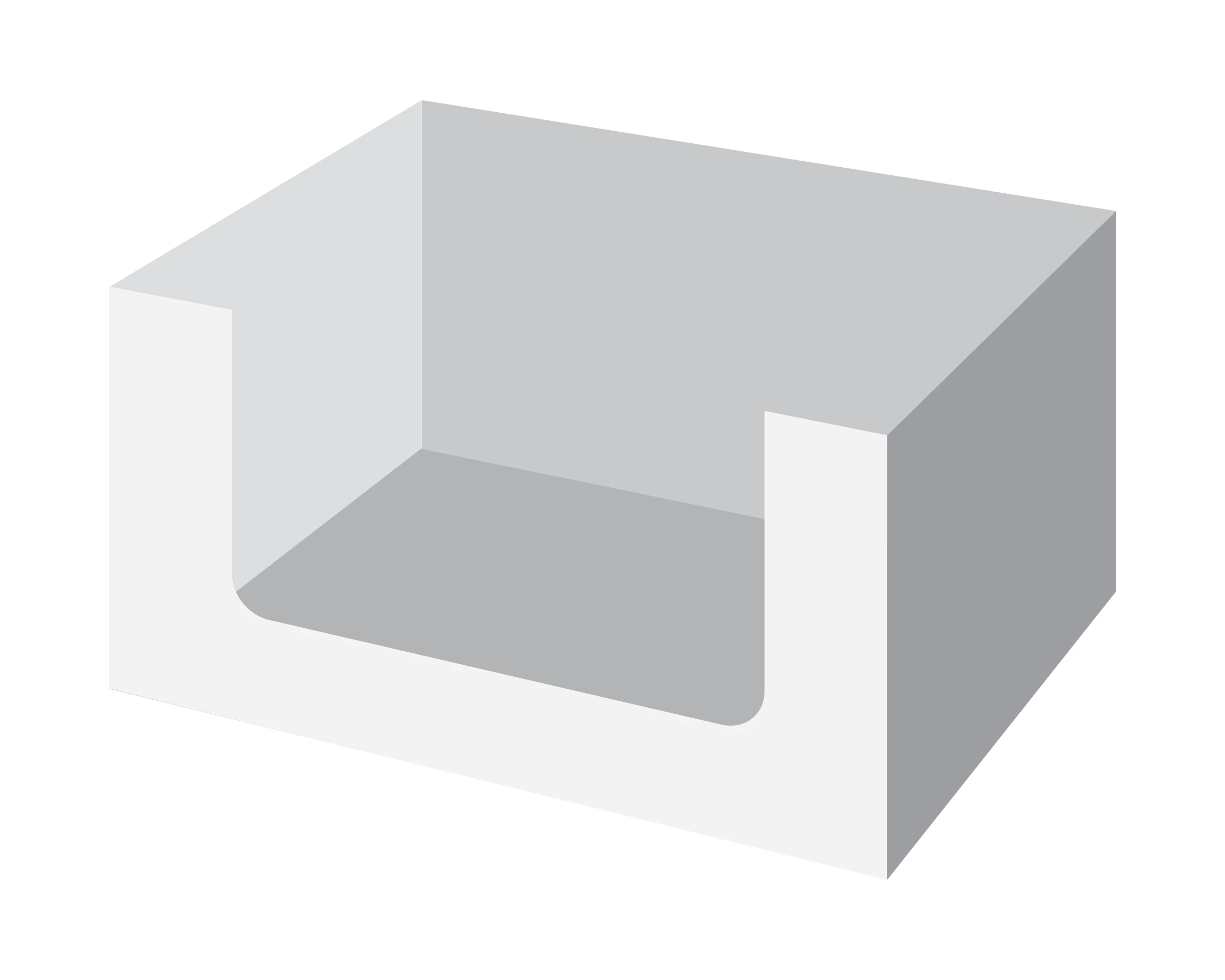

I'm attempting to create a 3D model of a corrugate tray which holds tetrapak juice cartons. Attached is a PNG of an illustrator 3D I created, hoping that someone with experience can supply me with the necessary steps. Is it even possible? Objective is to apply design to 3D in Adobe Dimension to show client fininished representation.

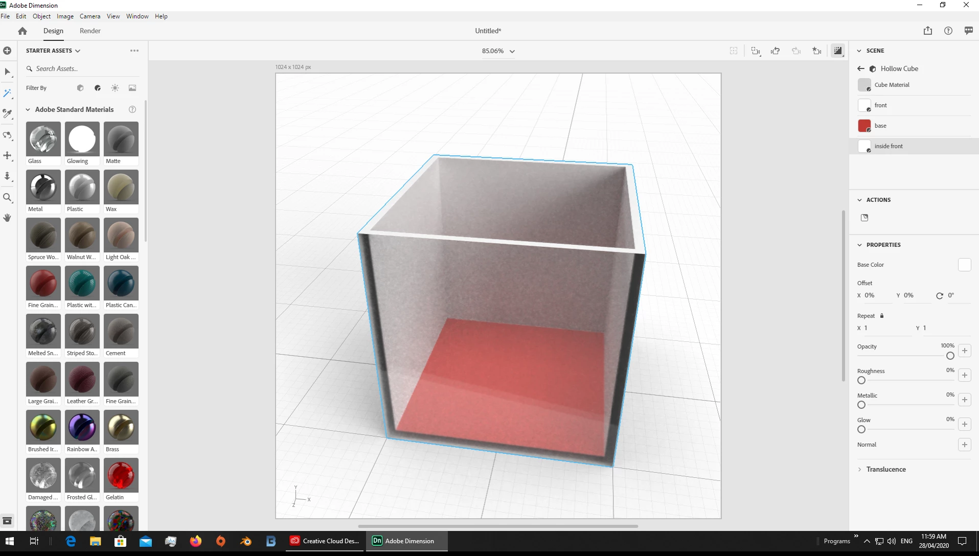

1 when you just want one or 2 faces removed from a box its quick and easy to do this in Dimension with just the magic wand tool

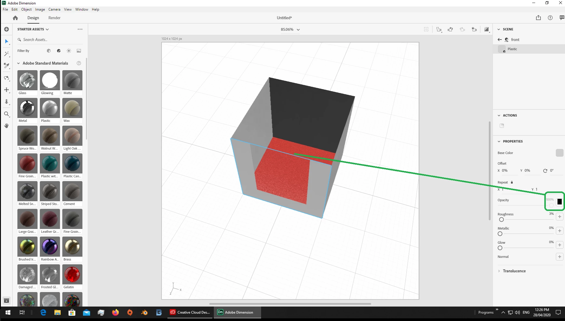

2 your shape is really 5 faces with one being a "custom" so option 2 is to build the box from flat faces [planes] and use an opacity map to hide the part not needed
+ its fast and ok for quick demos
- you can always see a line at the end of a map, ok if you have time to edit it out but clients could see it

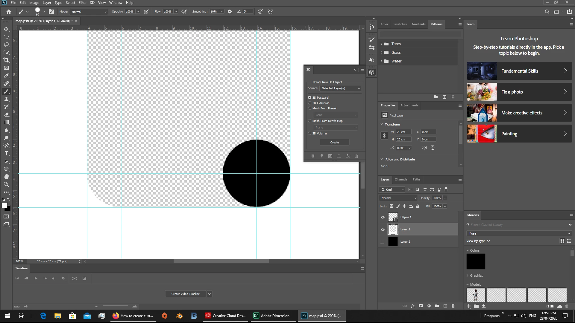

3 build the "custom" face [plane] in your 3D software of choice... I use Photoshop but Blender or even Maya are also fine
- takes longer than just using a map
+ looks better and once you make it then its there to reuse later
