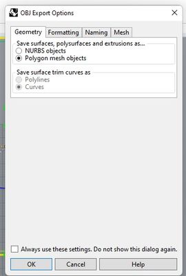

We have an obj made in Rhino that when imported into Adobe Dimension, breaks up into triangular faces and is generally unusable. Similar to the problem in this post: https://community.adobe.com/t5/dimension-discussions/export-import-issues-from-rhino-to-adobe-dimens...
We tried the export settings here but weren't successful.
https://discourse.mcneel.com/t/obj-export-settings-for-adobe-dimensions-felix/48390
On this forum the generally accepted solution seems to be to import the obj into Photoshop and export it again. I wanted to know if there's an alternative to this since it's an added step to a workflow that is very time-consuming?
Is there anything particular we should take a look at in the Rhino model, regarding the faces, UV meshes (although we are not applying any material in Rhino), or polygons? Or not necessarily Rhino, any 3D software that exports OBJ for dimension. Would appreciate any help!

Community Beginner , Sep 26, 2022 Sep 26, 2022
Solved.
Here's what I did in the end that worked.
Used Rhino 7 instead of 6. Used the attached export settings. Made sure to not include any curves in my export selection.
Adobe Dimension also has an opaque ground plane so if the objects aren't visible, see if they can be moved upwords in the z-direction.
Solved.
