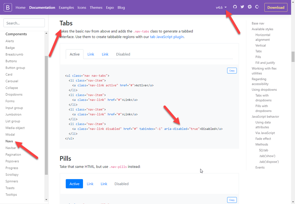

Community Expert , Jun 15, 2021 Jun 15, 2021
Am I missing the point? The subject of this topic is
Aria controls error
how can you continue to ignore this issue?
The following is cited in the linked document that I quoted:
Note that navigation bars, even if visually styled as tabs with the .nav-tabs class, should not be given role="tablist"role="tab" or role="tabpanel" attributes.
For a nore elaborate explanation: https://www.w3.org/TR/wai-aria-practices/examples/tabs/tabs-2/tabs.html

quote
 That's Bootstrap 5 documentation - did Bootstrap 4 get it wrong as the tab example on the Bootstrap 4 website includes the aria attributes that are missing now from Bootstrap 5 and replaced with buttons?
By @osgood_
This is for Bootstrap 4 - no role.

LEGEND ,
Thats not what is on the Bootstrap 4 official website, unless they have various versions listed. The version I posted directly from the website sample has 'role' and the other aria attributes mentioned.
A bit of  a mess how ever you look at it. 2 Bootstrap versions both using different approaches. I'd go with whats on the official W3.org website and forget Bootstrap as it seems to be a bit conflicting or just forget aria when using Bootstrap as if they can get this incorrect what other aria is potentially wrong.
quote
By @osgood_
It is important for Aria to be included if you do not want to be sued for neglect. One reason to choose `professional` developers over backyard hacks.
