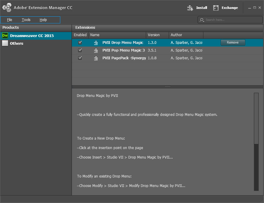

Mentor ,
Jun 16, 2015 Jun 16, 2015
Adobe personnel have no clue what is happening. We were able to get Extension Manager CC to work perfectly with Dreamweaver CC2015. The trick is to completely remove all prior CC versions of Dreamweaver, including user configuration folders. Then uninstall Extension Manager CC. Then install Dreamweaver CC 2015. Then look under prior apps and locate and install Extension Manager CC (even though the version number is the same it is DIFFERENT). Now launch EM CC from the application desktop and install your extensions (ZXP format). See captures...
We'll try to compare several different configurations and write up a process. The bottom line is this is a huge example of sloppy programming. Adobe seems to be attempting to coerce extension developers into using their marketplace. I would imagine, given the state of Dreamweaver's current quality, that the marketplace might be a stronger profit center than Dreamweaver itself. The architecture of Dreamweaver CC 2015 is not changed. Extensions are installed the same way. Adobe simply chose to take that ability away from users. And users will suffer financially because of it. Think Adobe. Put your damn thinking caps on and try to get out of your own way. This is all so pathetic.
