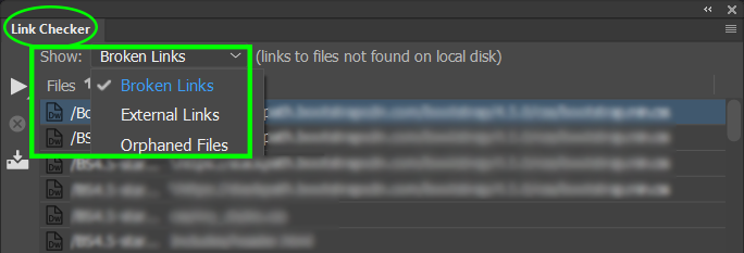

There is no magic button that cures hoarding.  Ultimately, you must decide which files to keep or delete manually.
That said, Dreamweaver has a built-in Link Checker to help you make those decisions.
Go to Site ⇒ Site Options ⇒ Check Links Sitewide to generate reports of Broken Links and/or Orphaned Files.
View or "Save Report" for future reference.
Happy housecleaning!

I can't answer that with any authority.  I will say that my local & remote site folders are similar, but NOT identical.
Certain essential server files should not be kept locally.  Conversely, some local files should not be kept on the public server.
You can expand your Files Panel for a side-by-side comparison of your Remote & Local Files.
