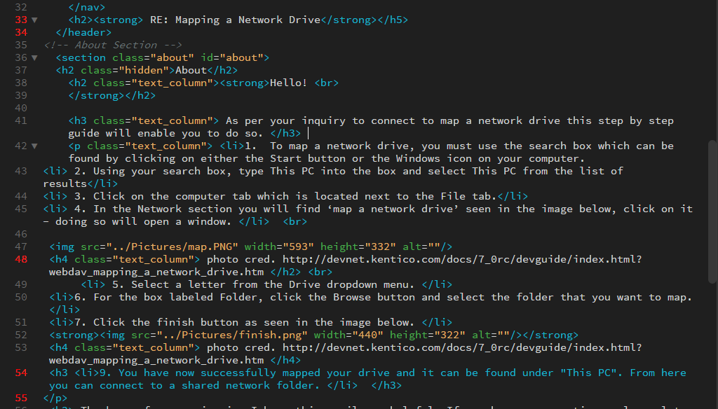

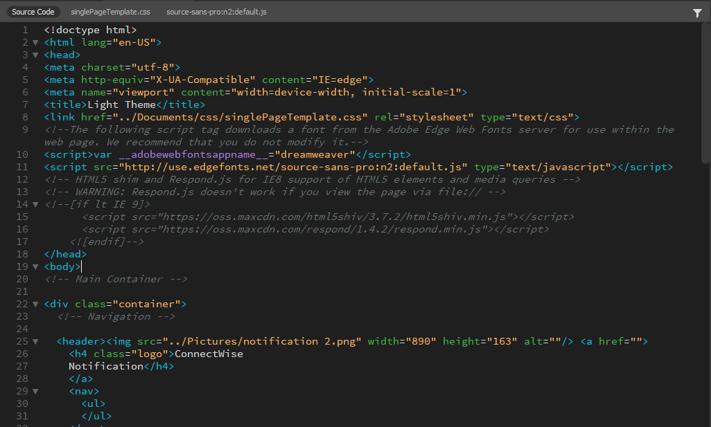

I don't know how to upload it so I took screenshots code.PNGcode 2.PNGcode3.PNG

When in code view,
  1. hit CTRL + A
  2. hit CTRL + C
  3. click on the Reply button at the right hand bottom of this post
  4. click inside the new dialog
  5. hit CTRL + V
  6. click on Add Reply

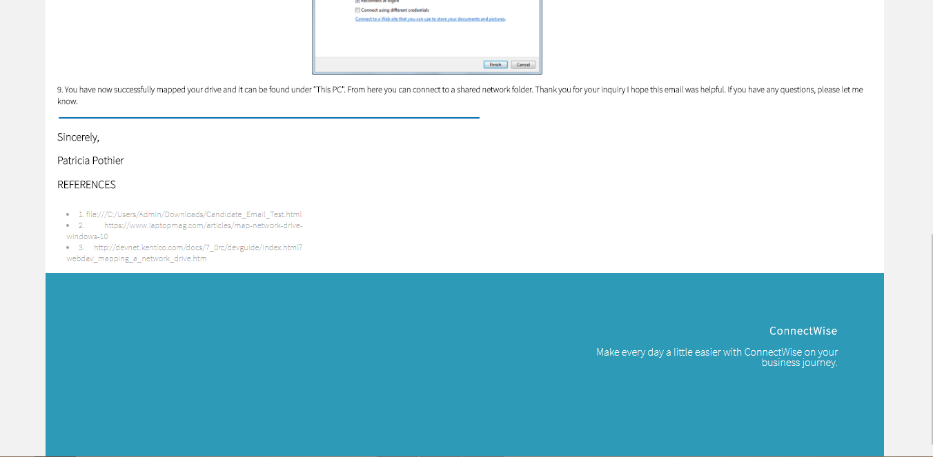

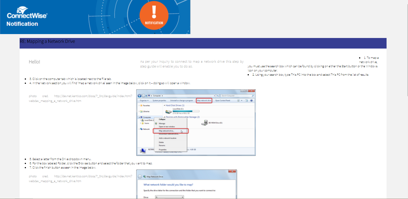

The original was written in HTML5 and I rewrote it in HTML4.01 and it looks a little better but it's stillconnect 3.PNGconnect 3 two.PNG cut and pasted all over the browser. The logo at the top should stretch across the screen. And the bullet points aren't lined correctly.
New Here ,
Jul 29, 2017 Jul 29, 2017
<!doctype html>
<html lang="en-US">
<head>
<meta charset="utf-8">
<meta http-equiv="X-UA-Compatible" content="IE=edge">
<meta name="viewport" content="width=device-width, initial-scale=1">
<title>Light Theme</title>
<link href="../Documents/css/singlePageTemplate.css" rel="stylesheet" type="text/css">
<!--The following script tag downloads a font from the Adobe Edge Web Fonts server for use within the web page. We recommend that you do not modify it.-->
<script>var __adobewebfontsappname__="dreamweaver"</script>
<script src="http://use.edgefonts.net/source-sans-pro:n2:default.js" type="text/javascript"></script>
I think the display problems are to investigate inside the file:
The original single-page-template works just fine.  It does not fill the entire viewport on desktop but it works as expected & is responsive on small devices.
Compare the original code below with yours & note the differences.
Use the Validation tool to check your code for errors.  You have quite a few.  Code errors will definitely effect display in DW and browsers.  Your goal should be to work with error free code at all times.
Incidentally, HTML5 is the current web standard.  Why do you think you need HTML4?
