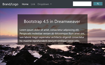

How can I make my Google Custom Search motor work without opening a new, popping window?
1. Google says for best results, use valid HTML5 code. You do not have a valid HTML5 document. In fact, you don't have ANY document. This causes browsers to be confused and behave in unexpected ways.
2. Your Google Custom Search Engine (GCSE) is a bit wonky too. I'll let you and your web developer sort that out on Google's Control Panel.
3. Meanwhile, I created a GCSE of my own and programmed results to appear in Layout > Overlay. Since my code is valid HTML5, my navbar's search engine works as expected. Try it with search terms CSS, PHP or HTML.
https://alt-web.com/DEMOS/BS4.5-nav-gcse.php
This just goes to show you that GCSE does work when it's deployed properly inside a valid HTML5 document.
