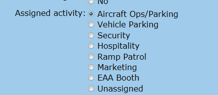

I have a PHP page which updates a MySQL table containing volunteer information - one row for each volunteer. Each volunteer has a field called "assignedactivity", the default value is "Unassigned". Administrators can update the volunteer record to assign a volunteer to an activity by selecting a radio button. This works fine and is shown below.
Now, my users would like to be able to also select an additional radio button - labelled "Other" and then type in an Assigned activity. I have no idea how to do this, if someone could point me in the right direction I would really appreciate it.
Below is the current working code for this field
