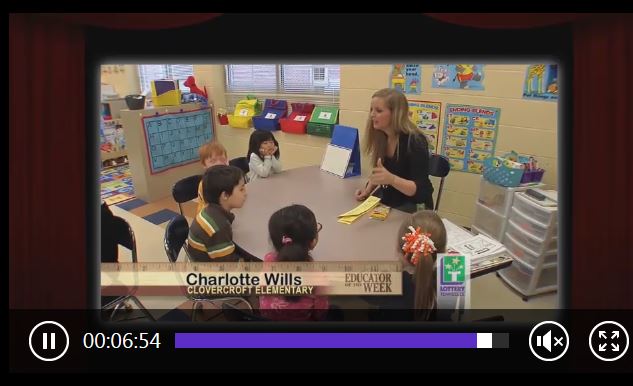

maybe of interest for you: In your newest version of your website (http://www.mindtrickvp.com/) your video now works in my IE 11!
See screenshot:
Hans-Günter
