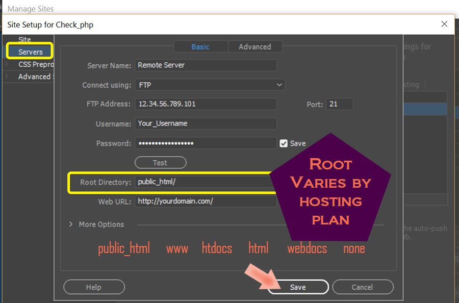

The first thing to check is that you uploaded the correct file (example, index.html) to the correct root directory on your server.  This varies by hosting plan. If unsure, ask your hosting provider.
Prior to migrating, it helps to have exported STE files that you can import into new Dreamweaver versions.  Failing that,  you can manually configure settings from the Manage Sites Panel.  See screenshot.
