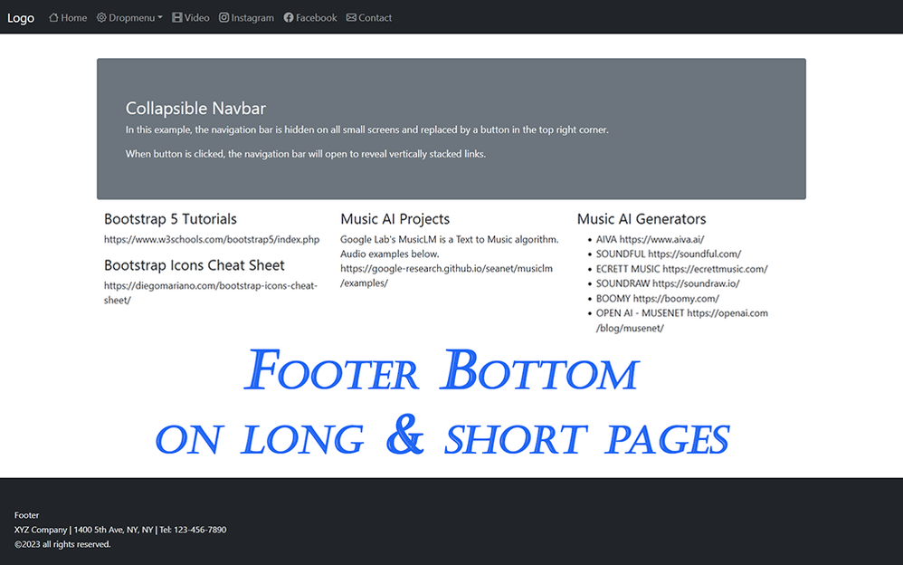

Mar 24, 2023 Mar 24, 2023
FOOTER BOTTOM ON LONG & SHORT PAGES  - Works in Bootstrap 4 or 5.
Step #1 add classes to <body> tag.
<body class="d-flex flex-column min-vh-100">
Step #2 add class to <footer> or its parent <container> if you use one.
<footer class="mt-auto">
That's all there is to it. 🙂
LEGEND ,
quote
By @Nancy OShea
I think we already solved that a few hours ago, using the exact same principles, but thanks for the clarification...........its a slow day around here, gets slower each day, I think, as DWs time runs out. What are we going to do to amuse ourselves.....hummm.

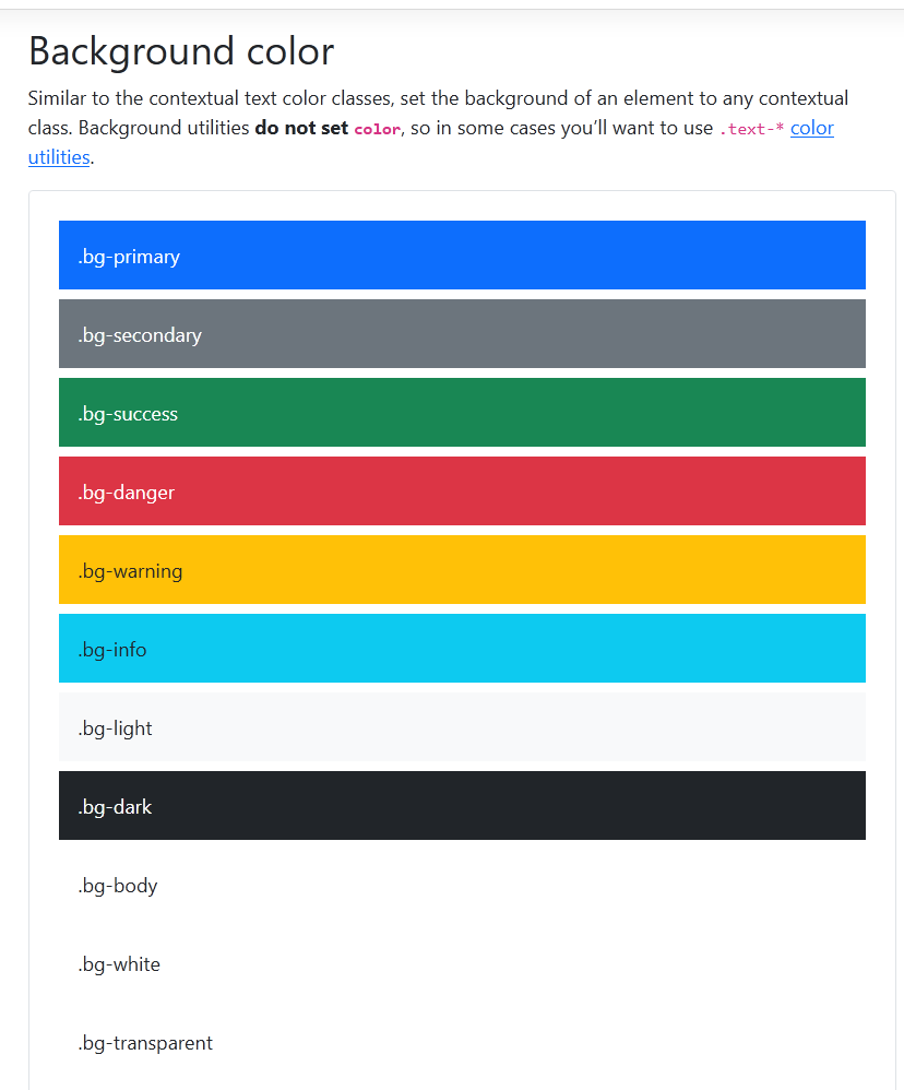

Mar 27, 2023 Mar 27, 2023
Bootstrap already contains built-in classes for changing bg colors.  Get familliar with the built-in classses.  It will speed up your production time so you can concentrate less on CSS styles & more on content.
Bootstrap Color Classes:
Result of adding bg-info to footer row.

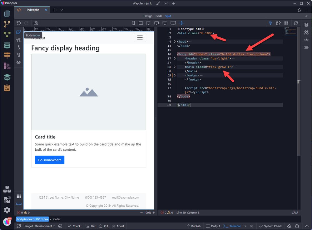

LEGEND ,
quote
By @Nancy OShea
Its NOT a case of changing the background color, the problem is the footer disappears in mobile browsers as a result of them having additional information bars which don't take into account when the css vh height property is used.
There are several hit and miss vanilla css solutions - the javascript one which I posted seems as though it might have more of a chance of working as it calculates the height of the device window.
I've only tried it on Android and it works in Chrome.  I have no idea if it will work on an Apple device running Safari or in Firefox - needs testing.
