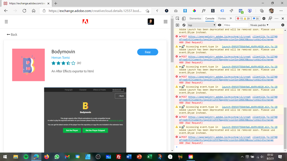

New Here ,
Feb 07, 2021 Feb 07, 2021
Same problem here.
New Here ,
Feb 08, 2021 Feb 08, 2021
