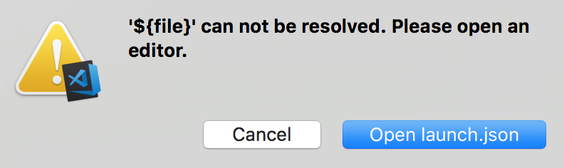

I've been making the transition to VS Code from ESTK, and have got things running, but I am finding the extension breaks often and I have to restart the host frequently.  I'm wondering if other users are experiencing this.  I'm no expert on VS Code, that's for sure, so I'm not sure if certain setting affect the performance of the extension.  I'm getting "Extension host terminated unexpectedly" and "'${file}' can not be resolved."

The latter refers to the configuration file that specifies "program": "${file}" as the file to debug (it's supposed to debug the open file).  Note that the extension runs fine most of the time, but I have to keep restarting.  Also, ES Debugger is the only extension I've installed, so that rules out conflicts between extensions.

I also get the "'${file}' can not be resolved." error consistently. Here are the steps to reproduce.

Actual: It fails with the error "'${file}' can not be resolved."
Expected: It should work again.
You can restart VSCode to get it working, but you need to restart VSCode every time.
