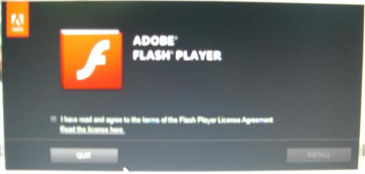

Here is what I get when I click "show details". And to circumvent your next question, nothing interesting shows up when I show information about this certificate.
Down below, after it downloads the install file, is what I get when I click on the "yes" button. If I don't click "quit" on the dialog below, I end up with the latest version of Flash. I then have to go through the "clean install" procedure to get rid of it. I reinstall 10.3 and have to live with the blinking shield asking to install the latest version of Flash.
Time to answer the question. How do I get Flash to stop asking me to upgrade?

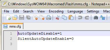

A couple of things to try. First, let's try modifying your mms.cfg (located in c:\windows\syswow64\macromed\flash to add the following line:
AutoUpdateDisable=1
If this file does not exist, just create it using a text editor.
Next, open up the FlashInstall.log and paste the contents in a reply post so we can see if there's something else triggering this install.
Chris
Copy link to clipboard
Copied
Thanks for responding.
The AutoUpdateDisable was set to one.
Below is an image of the mms.cfg file. The file had been as shown in this image – I did not make any modifications.

I have checked the config file and appended the log as you requested.
I am still constantly being bothered by this flashing icon asking if I want to upgrade Flash.
Any more suggestions?
Barry.
