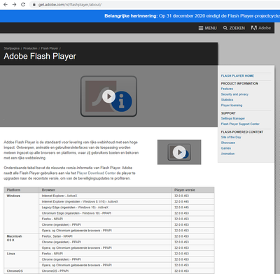

    Tim5EACAuthor
    Nov 27, 2020 5:57 PM UTC
    Tx!
    Well, I'm not finding the value in the mms.cfg which can fix this.
    On 2021/01/11 it works ;
    when I change the date to 2021/01/13 it results in this :
    remco82641
    Nov 27, 2020 6:06 PM UTC
    See chapter 4 and the mentioned examples in the admin guide. You would need to use 'EnableAllowList' and add the urls to 'AllowListUrlPattern'.
