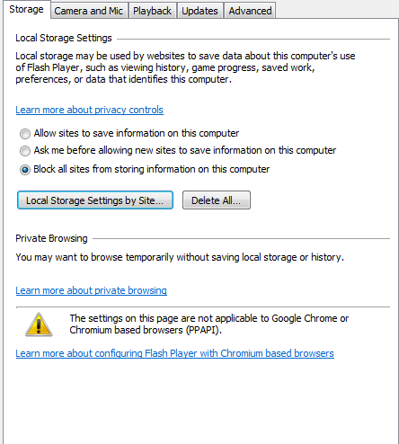

We're trying to set up mms.cfg settings to be the equivalent of the following settings in the Local Settings Manager.
For Local Storage Settings - "Block all sites from storing information on this computer"
For Camera and Microphone settings - "Block all sites from using the camera and microphone" (We think AVHardwareDisable=1 is correct for this setting)
For Peer-assisted Networking - "Block all sites from peer-assisted networking".  (We think RTMFPP2Disable=1 is correct for this setting)
So, what are the equivalent mms.cfg settings to mimic the Local Storage Settings "Block all sites from storing information on this computer"?  We've done extensive testing with the Local Storage "Block" setting and it works well for us.  We would like to migrate the equivalent to the mms.cfg file for administrative purposes.

Thank you for your response.  It seems to me that LocalStorageLimit affects the settings shown below.
versus
It would be reasonable to assume that if you set LocalStorageLimit=1 (no storage) then that would block all sites from storing information on the client.  I guess it all hinges on what "storing information" means - that's not very specific.
