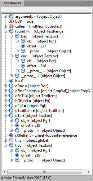

Status of the Data Browser is when I am on line 17 of the above snippet:
  • It can be seen that oTL gets the same offset as tloc (assigning an object just creates an alias), but really cloning the object does not help.
  • Replacing break by continue (to run also the useless second iteration of the k-loop) does not have any influence, because oFnTI.length is always 1.
  • Nevertheless the k-loop is necessary: oFnTI[0].obj.TextLoc is an invalid object.
