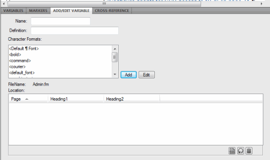

I'm using FM 10.0.0.388 on Window 7 as part of Tech Comm Suite 3 and I can no longer edit my user defined variables.
At some point in time, and I'm not sure when, I am no longer able to edit my user-defined variables.
I can create my variables, and insert them into the text, but if I select a variable, and click edit to change the definition,
the Add/Edit Variable screen is blank and I cannot chcnage the text.
Here is my list of user-defined variables:
If I select one, let's say "product4", and click the Edit icon, the Add/Edit Variable screen is blank as shown here:
Even if I try and redefine the variable as "product4" again, nothing changes. It keeps its initial definition.
This is a HUGE problem, since I rely on Frame for constantly changing product names.
Any suggestions would be greatly appreciated.

Upon further investigation, I have found a workaround for this problem.
It seems that if the variable is defined, but is not actually used in the text of the document, the variable cannot be edited.
However, if I insert the variable into the text of the document, I can then edit it.
This is not the same behavior as my co-worker who has the same TCS3 setup as me.
She can edit the variable definition whether it's in use or not.

Godd suggestion. I just tried this, and put a table of all my variables onto a reference page, but it doesn't work.
I've learned in additional testing, that the variable actually has to be selected within the text in order to be editable.
