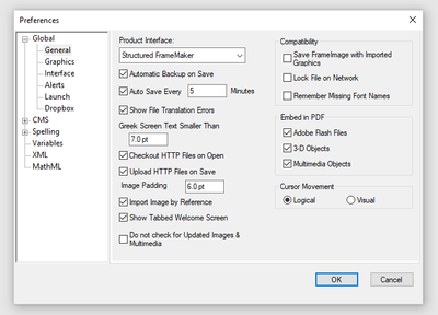

Autosave is an interesting issue. I assumed it was turned on by default, but apparently it is not. I recall that autosave affected performance when files include lots of graphics and are stored on a network.

On auto-save, in a networked-FS situation, auto-save can't save any faster than a manual save. For documents that contain only referenced graphics, this shouldn't be a huge timesink. Embedded graphics are another matter, and another reason why they are worth avoiding.

An extremely rare correction to one of Bob's posts: The backup file is not created when you open an existing document, but rather created when FrameMaker saves a doc with the Automatic Backup on Save option enabled.
True, FrameMaker will instantly and gleefully delete the backup, but before trashing the backup, there's an appropriate dialog asking if gleeful deletion is what you want.
(FrameMaker may come with a few interesting "features" but I don't think sadistic destruction of content is one of 'em)
One other point to mention...when opening backups, recovers, and autosaves, the filename retains the appended extension (.backup, .recover, .autosave, if I recall correctly). It's at that point where I also do as Bob recommends, and save off that file for comparison if I have doubts about which version with which I'll want to go forward. The retained extension helps prevent overwriting of the original, but it does cause a bit of consternation and confusion if you're not looking closely at the extensions of your "recovered" files.

Using Autosave options in the Preferences can be helpful and setting Backup on Save can be helpful but creates a lot of extra files to wade through. However, when you try to reopen your file after a crash, I would expect to see a message about the crash recovery file (.recover) that you can open and save off as a file to potentially save that hour of work that you did.

there should be recovery files, but when I am correct @stephen_9000 is using a network share for the FM files.
FM has only a very short time period to save recovery files and a network share is really slow compared to a local folder.
As there was a file named "filename.fm.492", I think FM tried to save recovery files, but ran out of time (0 bytes).
