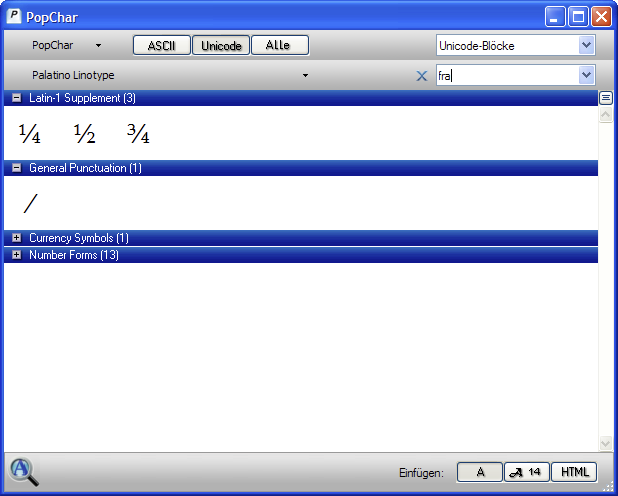

you are using FrameMaker 9 with all Unicode capabilities. So you can take advantage of modern fonts with many more than just the so-called ANSI characters. My favorite tool to find them is PopChar. E.g. Palatino Linotype contains all digits for super- and subscript numbers, as well as the fraction bar. You would find them as well using Charmap.exe, but searching for fonts which contains certains characters is one of the features of PopChar
http://ergonis.com/products/popcharwin/
See attached screen shots.
