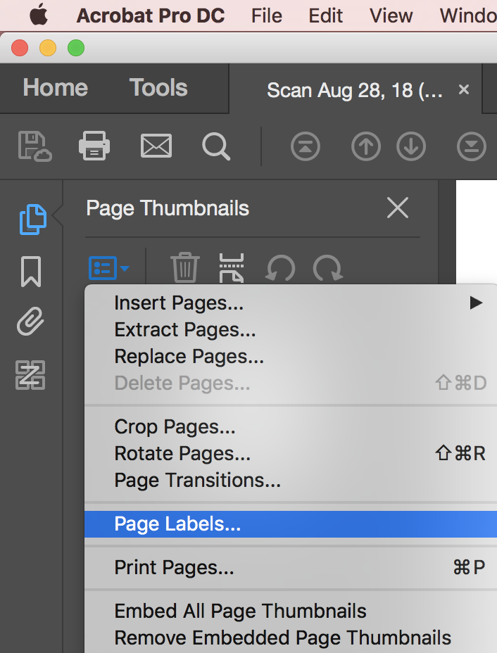

Hi Shane:
You can set the page numbers in Acrobat Standard or Pro via the panel menu in the Page Thumbnails panel > Page Labels. If you need more details on the Acrobat workflow, please ask on the Editing & Exporting PDFs forum. This is the FrameMaker forum.
