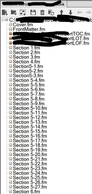

Thanks for the helpful pdf containing tips. One has to understand how the Bk was originally built, and that's where I am unsure.  In FrameMaker V16.0.4.
The Bk file contains four sections preceding the a series of sections 5-1 to 5-27. The prior writer set up those 4 initial sections and the letter "S" is employed in the FM Numbering setup window. None of the ideas offered in the helpful pdf you provided address a book that starts with four sections numbered consecutively, and then sections 5-1 through 5-27, with a final Section 6 (which is an Acronym list). It's those sections 5-1 through 5-27 that go out of order. Each attempt to gen or re-gen, the Bk picks up a Numbering error. Also it says it can't open some files to generate the .Bk because the file(s) contain missing fonts. When I click the option to Reformat using available fonts, why doesn't that election "stick?" Why would it keep prompting for fonts that are already accepted from the last Save? I'm definitely interested enrolling in FM training. But I am on a deadline as many of us are and must resolve the Numbering issue to help generate a book without errors.
The uncorrupted, original book has the first five sections w Numbering settings S:<$chapnum>.
Section 1 contains subsections 1.1, 1.2, through 1.5
Section 2 contains subsections 2.1, 2.2, etc.
Section 3 contains subsections 3.1, 3.2, etc.
Section 4 contains subsections 4.1, 4.2, etc.
Section 5-1 contains subsection 5.1, 5.2, etc.
But Section 5-2 then has different Numbering settings: S:<$chapnum>.<n+>\t
And Sections 5-3 through 5-27 also show S:<$chapnum>.<n+>\t
For the Headings that are at level 3 (3Headings), it's S:<$chapnum>.<n>.<n+>\t
I just do not understand how this keeps getting scrambled or "undone" when I attempt to regen after editing content. Something is renumbering the sections so that when I open Section 5.4, the headings inside of Section 5.4 say 5.3, or when opening Section 5-10, the headings say 5-8. All of the errant numbering as listed earlier in my post of Aug 13.

I reviewed the files and the numbering worked properly. When I first received the files, I opened the files and updated the book. There were a few errors, but it updated properly. I also instructed @PammerT how to update the conditional settings for the entire book to eliminate that error. Finally, I suggested using a book folder for all the parts of chapter 5,
Community Beginner ,
Aug 18, 2022 Aug 18, 2022
Thanks for the excellent help and ideas. The Bk folder sample looks great. I don't know how to alter the existing book structure to employ a book folder for all parts of ch 5. Appreciate the suggestion.
